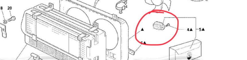

If the resistor is bad, I think you loose the slow speed for the fan but they still work, only at full speed.

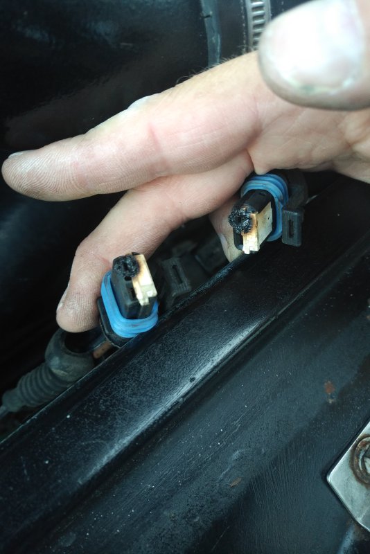

Many thanks for the replies, I checked the fuses and all seem to be OK, next i checked the fans with a direct 12v feed and they are working, however discovered the connectors are shot. so hoping this is the issue but will probably replace resistor too while i am at it.

Re: Maserati 3200 Cooling
Not good
