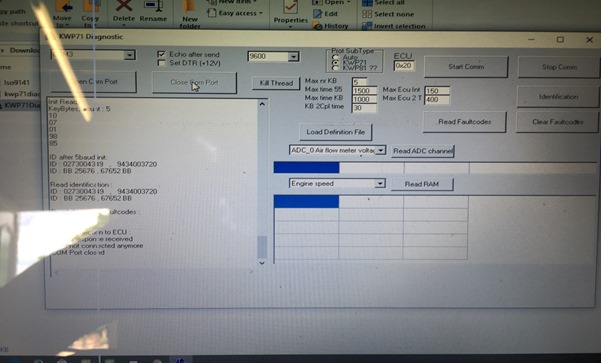

joeley a écrit : ↑mer. 8 juil. 2020 20:26 Aux dernières nouvelles de Facebook, KWP71 marcherait pour l'abs et l'airbag.
"ABS system diagnostics for 3 pin series 1 cars. The ABS diagnostic port is under the bonnet near the ABS unit. It should have a weather proof cover. The cables used are the same as reading the engine ECU, Alfa / Fiat 3 pin with a +12v supply from the car battery and a vagcom to usb . The vagcom cable needs a driver available from http://www.ftdichip .com
First time uses plug the cable into your laptop click control panel – device manager – ports (com lpt) – double click- this will give you your com port for the cable make a note of this.- Double click- under properties it should show this device is working properly. click-port setting-click- advanced- change the latency setting to 1. Click -OK-
Plug the cable into the cars diagnostic socket Open KWP71 change the default settings as shown in photo. Add Com port (your own value noted ), the other values are as shown. In the ECU box 0x20 is for ABS 0x10 is for Airbag
-Open com port- start coms- read fault codes-stop coms- close com port-
Working on the Airbag the car doors should be open to stop accidental inflation The airbag diagnostic port is inside the car on the RHS of the transmission tunnel."
Pour info, et je n'ai rien vérifié...![]()

J'ai un logiciel sur PC pour lecture défauts sur prise OBD. J'ai effacé tous les défauts existants mais le voyant reste allumé
Je vais réessayer cet AM
