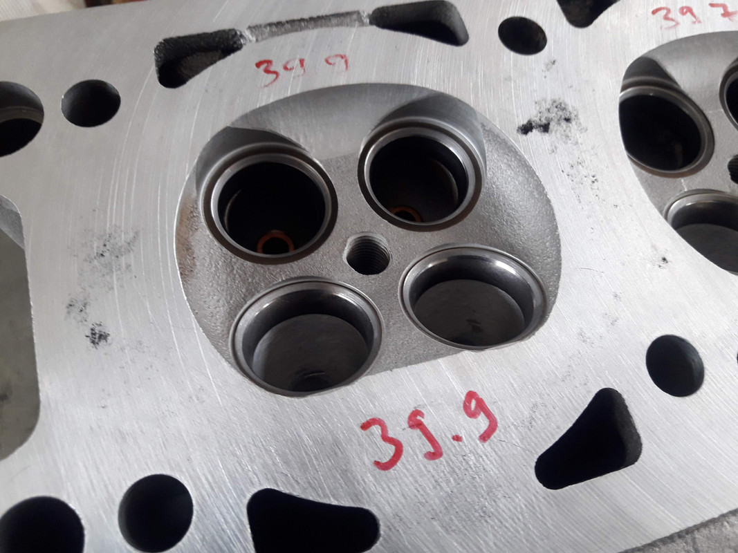

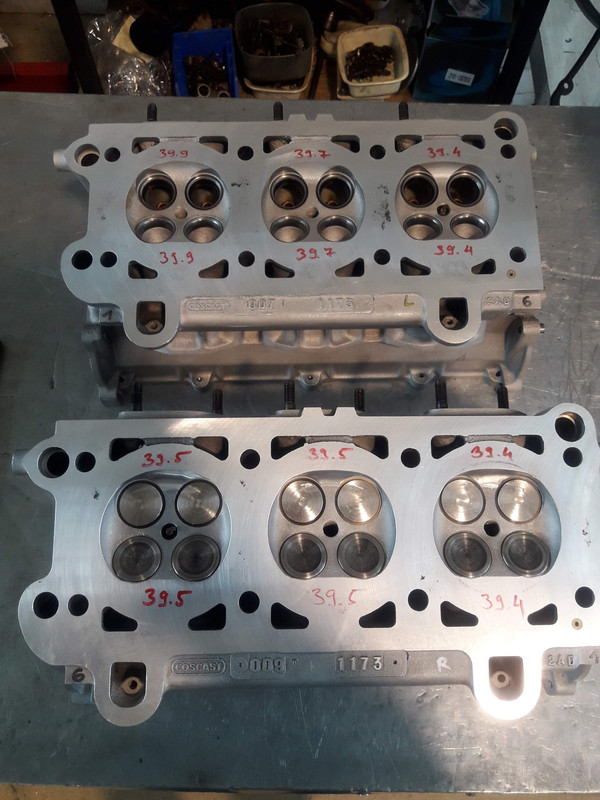

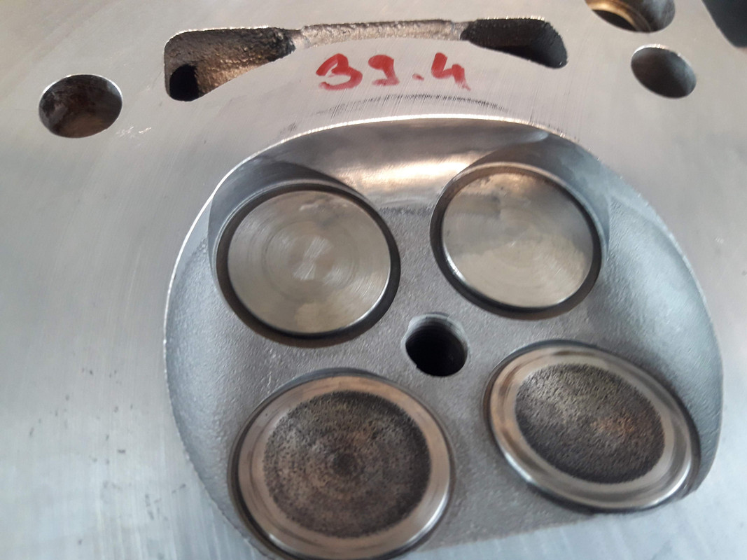

I'm pretty late with this, but after going back and forth wit the solutions, the cc volume mismatch was solved by minor adjustment in the cc itself. This brought everything in the required ±0.5 cm3 diff. And the heads can be reused in the future without having to touch any other part.
One of the touched up cc
As visible these were already touched up slightly in the factory, on some only machining marks are visible, but on some there are rougher hand made marks
Heads are now installed, valve clearance measured. I have the new shims, they are just waiting to be installed in the coming weeks. Then set the timing and pretty much done with the engine.

Why not to machine the chamber. I'd rather unshroud exhaust valves instead of removing between them. These angles just above valves restrict the flow, removing them does not hurt.
But as I said I'd machine piston tops.

You mean to bevel / blend the edge right above the seats? I guess that would help for the flow, but not for my nerves if doing this after the valve job (wasn't done by me but still) :) This was a simple and fast solution. Just like the piston tops as you said, but I didn't wanted to disassemble the block again.

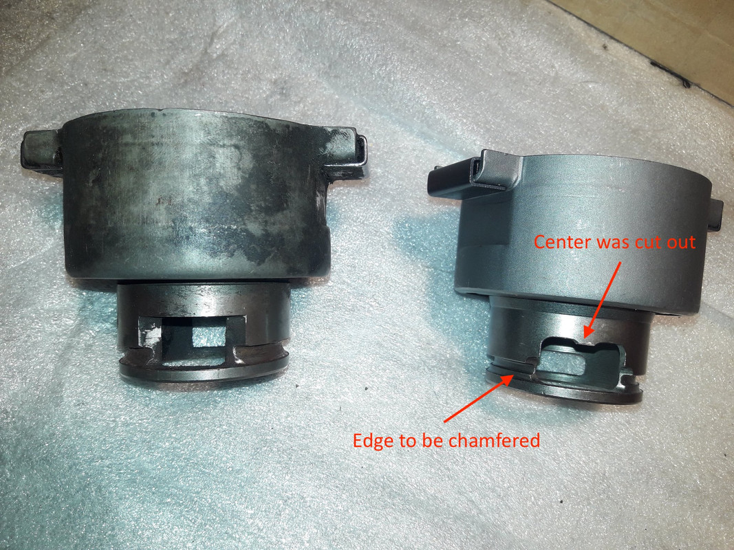

The engine was finished in May, and then it took me some more time to install all the accessories on it, and finish the engine bay. The engine was back in the car in June, cleaned all the cooling system, air pipes, and started up for the first time in July. Got some serious noise, which turned out to be the CO.ME clutch set which is not fully compatible. Instead of tweaking it, gearbox up and down is not so funny on jack stands, the original Sachs set was refurbished and I've installed it. I did source a new release bearing (Sachs 3151 600 781), which despite being a remanufacture of the original, still needed some adjusting, cutting and griding here and there. I was able to get one of the last ones, but unfortunately it seems this is again not available, only for stellar prices.

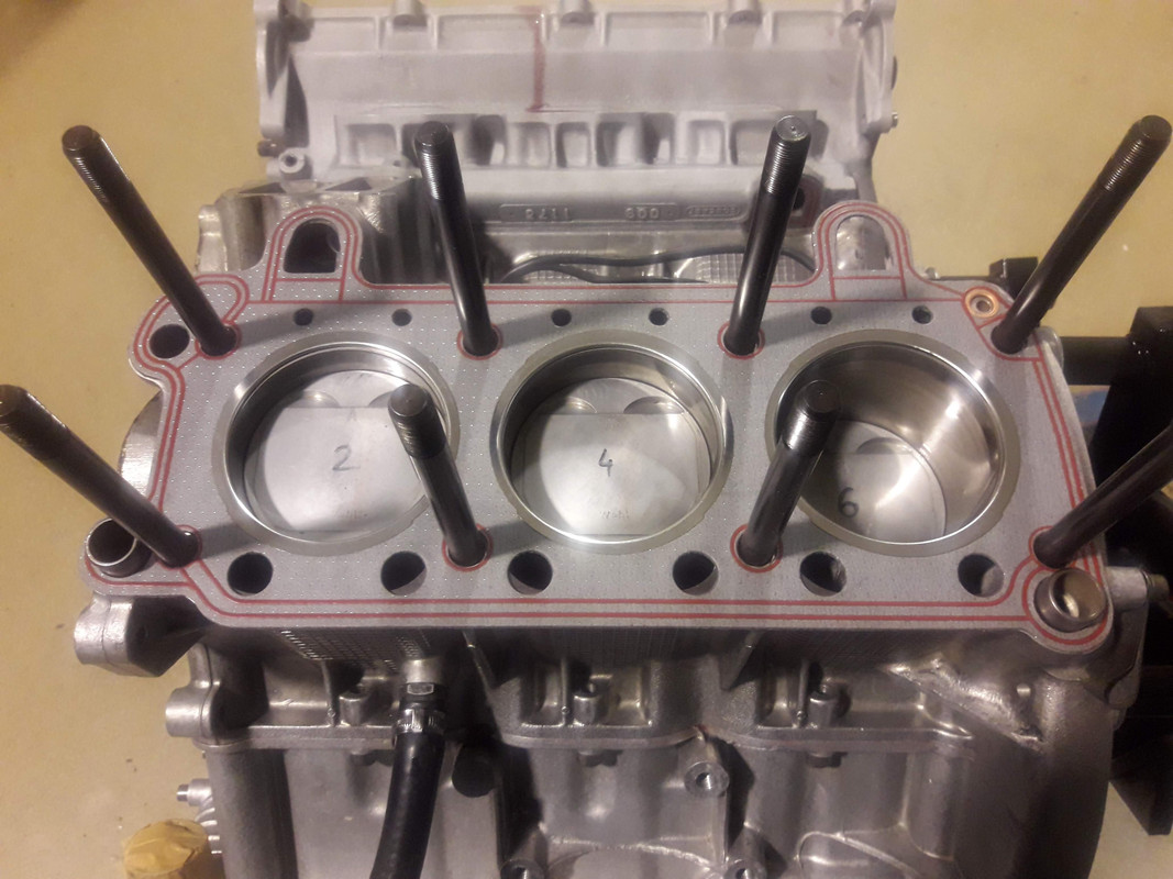

I did a leakdown test, on the right side, there were no bubbles coming up in the expansion tank, but the coolant level did increase. During engine rebuild I didn't remove the liners, there were held down with washers and nuts. It's not possible that they sink down right? There should be a lip on the bottom I guess. The block also wasn't touched, so they also can't protrude above the deck surface. Any idea how coolant gets into every cylinder on both sides? I can't see how this is happening with resurfaced and straight heads and new gaskets.

I don't think the problem could be on the head gasket side, today there is no mystery in the composite gasket technology. If they were properly installed and torqued they should not leak. And the probabilty to have leak on all cylinders is close to zero.
Are you sure to have the 2L and not 2.8L gaskets ? 2/2.8 heads are identical but the bore is different.
