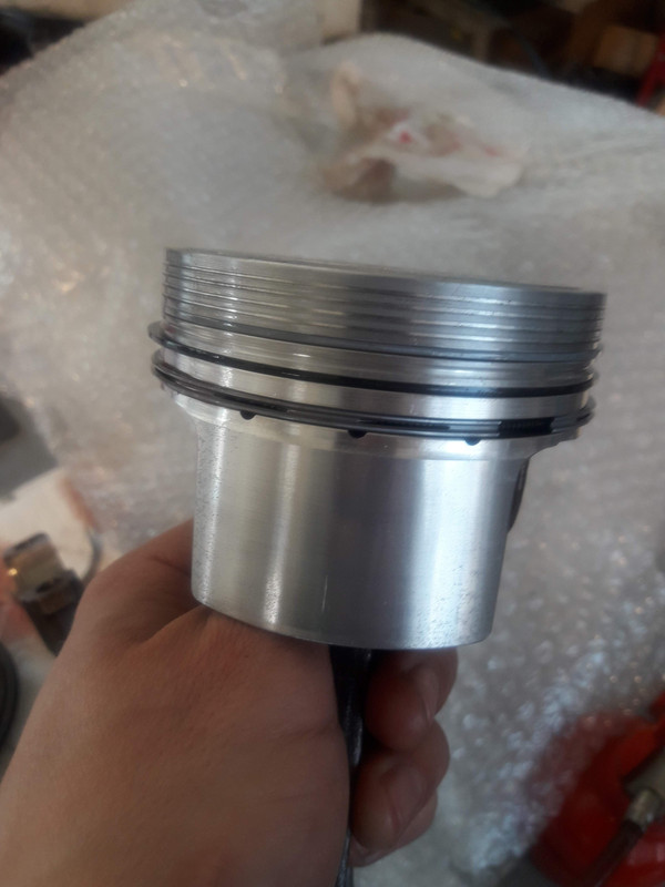

I found rings at Wahl Pistons (they were originally with Mable, still using their blanks) in Germany. They kindly even offered to swap my 1.5 set with a 1.2 set. But to be completely sure I've sent them the pistons and the pins. In the pistons they cut contact reduction grooves above the first ring and an accumulator groove between the first and second ring. Also measured the grooves and turned out the axial clearance was too big so they did cut 1.5 grooves. Besides on the second ring they cut a Napier groove. With all the modifications the changing to 1.5 won't be such a big issue. The pins were also reconditioned, they used a method which is even finer than honing. All of the above on a very reasonable 25 EUR / piston price.

spacecadet a écrit:With all the modifications the changing to 1.5 won't be such a big issue. The pins were also reconditioned, they used a method which is even finer than honing. All of the above on a very reasonable 25 EUR / piston price.
It's cheap for sure.
And for sure the engine will work with thicker rings. They are just heavier and higher tension, I understand they seal less on partial engine loads and they may vibrate at high RPM.
They all add everywhere these decompression grooves, I understand they are needed only when the volume above the ring is low like on modern pistons. Otherwise they lower sealing even more on partial loads. It's good for high boost engines, 1 bar is not high, race engines run 1.5-2 bars boost. I don't remember how are Ghilbli pistons but I believe the crown is quite high so it's already "decompressed". Well I'm not an expert.

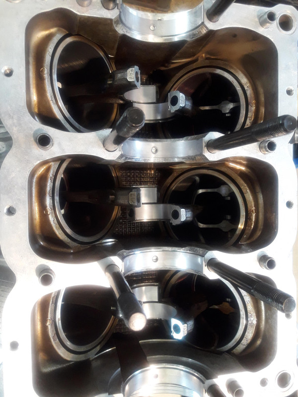

I'm especially not an expert so I accepted their advice after explaining the parameters the engine. But your points do make sense as well. Since there is no turning back now (don't want to buy new pistons), I put together the block.
I also put back the valves into the heads earlier, but found some left-over dirt hiding in the oil galleys :cry: Finally today was engine build day, so took apart the heads again, and clean, clean, clean. It's pretty much spotless now. Then measured the combustion chambers. 38.5 cm3 on one head, 40 cm3 on the other. Damn machine shop :x Calculating with 38.5 cm3 the compression ratio changes from 7.6:1 (that's with the factory 41.5 cm3) to 8:1. I hope it's acceptable. Probably will take down a bit more from the other head too, to get identical numbers. Hopefully won't consume both in the end :lol:
Feels like 1 step forward, 2 steps backwards, but I'm telling to myself, it's better to discover these things before assemby and getting a badly running / short living engine.

Messagede alpa » Dim 2 Déc 2018 12:13
spacecadet a écrit:I also put back the valves into the heads earlier, but found some left-over dirt hiding in the oil galleys :cry: Finally today was engine build day, so took apart the heads again, and clean, clean, clean. It's pretty much spotless now. Then measured the combustion chambers. 38.5 cm3 on one head, 40 cm3 on the other. Damn machine shop :x Calculating with 38.5 cm3 the compression ratio changes from 7.6:1 (that's with the factory 41.5 cm3) to 8:1. I hope it's acceptable. Probably will take down a bit more from the other head too, to get identical numbers. Hopefully won't consume both in the end :lol:
Please don't touch the heads !
Yea it's difficult to find competent people. I wonder if they still exist. I prefer doing machining by a general mechanic machine shop: they don't pretend to understand engines, they just properly do whatever I ask them to do.
Check again chamber cc. If they are that different then check piston crown thickness. If you have let's say 5mm of thickness then remove some material from the top to increase the cc. You don't care about pistons, at the next rebuild they'll be worn. Ghibli (like all our biturbo engines) run lean (stoichio in boost), increasing CR that much is dangerous.
The other valid solution would be to use a thicker head gasket but they don't exist, you would need a custom made one. I wonder if we'll end up with this solution anyway, after having surfaced the heads 2-3 times.
