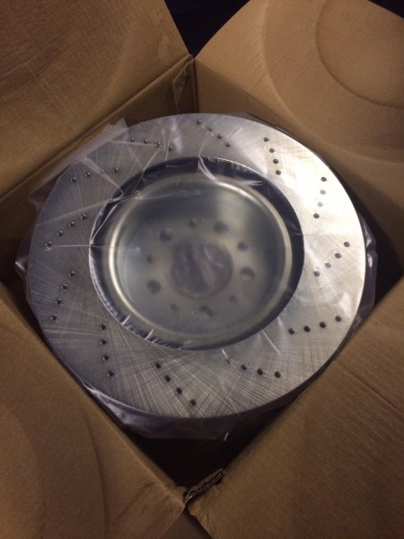

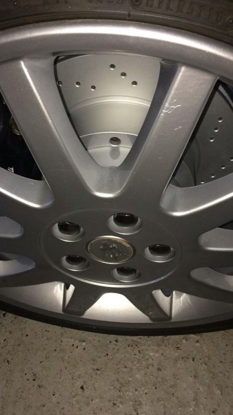

Messagede Konimino2 » Jeu 27 Sep 2018 22:25
sur FB groupe 3200
Neil willetts de guilford, vend les 4 disques 450 euros.
There are made from GG15HC steel which is higher carbon and less prone to cracking. The discs are also GEOMET coated to protect from corrosion as most of these cars now do not cover many miles a year.
You will get 2 discs with this purchase supplied in 2 boxes. They are left and right handed.
In stock ready to go today!
ISO/TS16949 Certified
09680220 R and 09680220 L
Image de Neil willetts facebook
Image de Neil willetts Facebook
Messages: 4872
